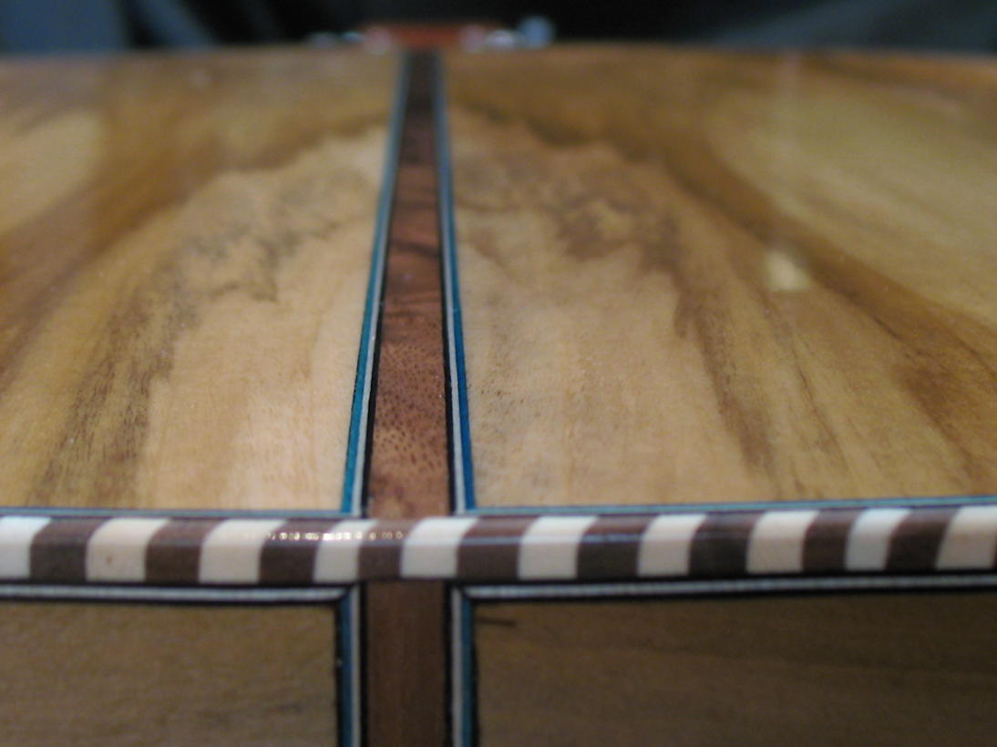

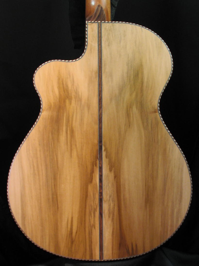

Some pics of Dave Freemans Magnolia guitar
PostPosted: Sat May 19, 2007 4:13 am
Wow, interesting looking guitar! I've not seen Magnolia with that much visual appeal. Here's hoping mine looks so good.
Thanks for posting, Martin!
